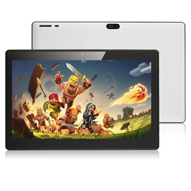

    THESE ARE IN NO WAY 'FLYTOUCH 10' MODELS!
    I know what it says in the about page but anyone can spoof a model name in build.prop. These are in fact SuperPad 10s http://www.alibaba.com/product-detai...622115746.html Look familiar?
    TabTronics lie about the spec of these devices (NO GPS and only 1.4ghz NOT 1.6)! I got mine for free because they wanted me to keep my mouth shut about their false advertising. Just shows how dodgy some people can be.
    Anyway, I now have a FREE rk3188 tab to play with. First off spec. The parts inside this tab seem to be a mix of rk3066 and rk3188 gear (Notice the Flytouch 9 is the same form factor and an rk3066?).
