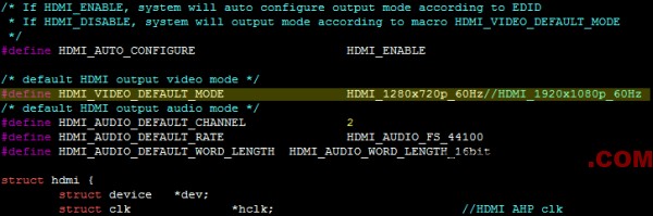

    since i own a device that there very small community did someting for it , i want to know how i can patch the stock kernel to display true 1080p resolution
    i own a rk3066 device with android 4.2.2 , 3.0.36 kernel
    is any of these solutions going to give me positive result ?
    using the command via terminal on stock kernel
    am display-size 1080x1920
    or do i need to change a single line in rk30_hdmi.h file
    waiting for help from the more experienced guys
