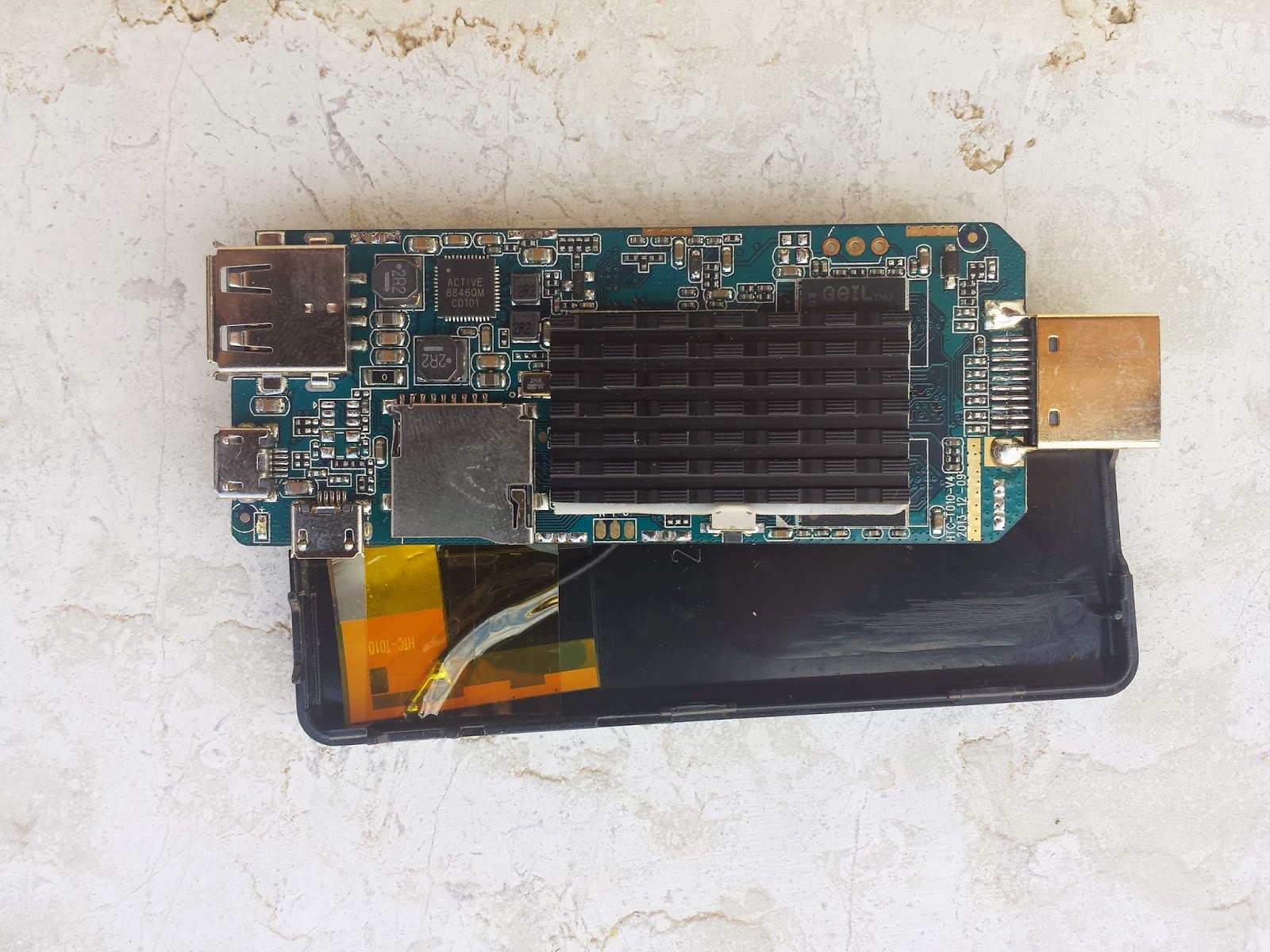

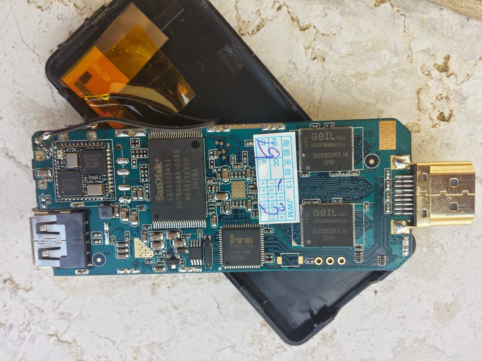

      Thanks for reply. I opened it but can't understand how to check chipset. Here are screenshot.
      I tried installing This firmware http://www.freaktab.com/showthread.php?12565-Help!mk809-with-rk3188-rtl8723bs-wifi-amp-bt-chip&p=206090&viewfull=1#post206090
      But again same problem. It booted but no wifi and no Bluetooth

        I thinkI've MK809III (RK3188T) with MEDIATEK mt5931sa / mt6622n wifi/bt chipsets.
        Any rom compatible with these chipsets?
