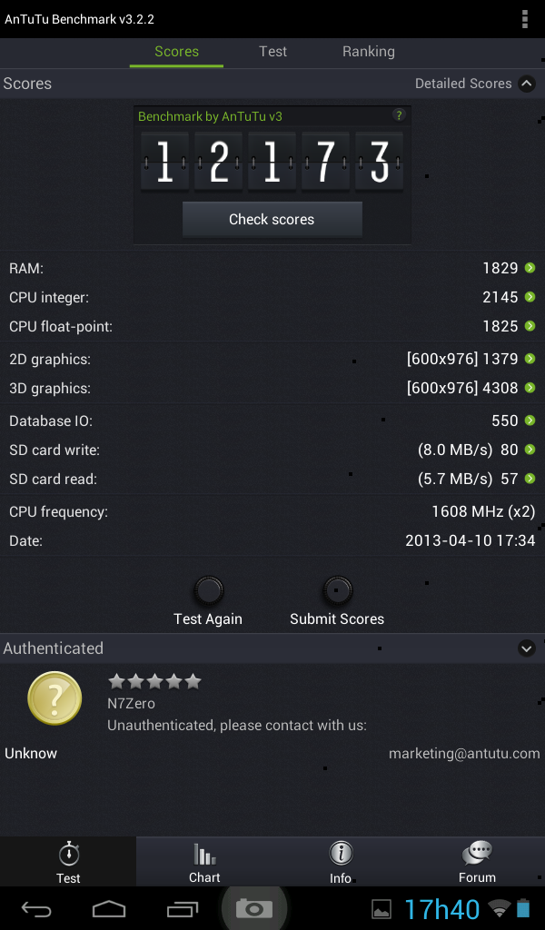

              I have a n70s, and my antutu scores, still with the Stock Rom from December was 12173.
              And now it's much better.
