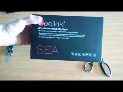

    1.Beelink SEA I TV Box
    2.HDMI cable
    3.Power Adapter DC12V 1.5A(100-240V,50/60Hz)
    4.Operations guide
    5.Infrared remote control
    Packing size: 196 * 121 * 75mm
    Product size: 188 * 119 * 20mm
    Beelink SEA I unboxing
