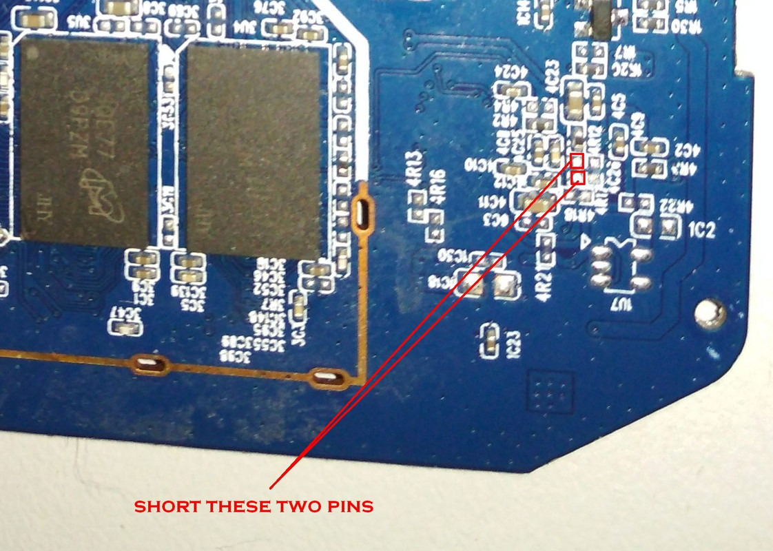

    I tried shorting pins. No idea witch ones now but it took forever. As there was a few to review. Let me see if I can find the photo.
    Many devices now mk902ii/Shield/Mk68 /Ugoos/neox5/minix5 (yes they still work lol) mk80 no it doesnt work lol.

      That's just the thing, there are no eMMC pins on the Iron

        Which one I should short of those?
          #19
          That' the connection for refreshing. I forget witch ones but I did get it seen using those. I think it was middle 2 but forget sorry.

                      Scooter Can you please agonize that grey mass of you one more time to make sure which pins exactly you shortened to get in Mask Rom mode?
                      I have tried all combinations of the pins you suggested without any result.
                      Thanks

                              #29
                              Еnter mask ROM mode
                              detail
