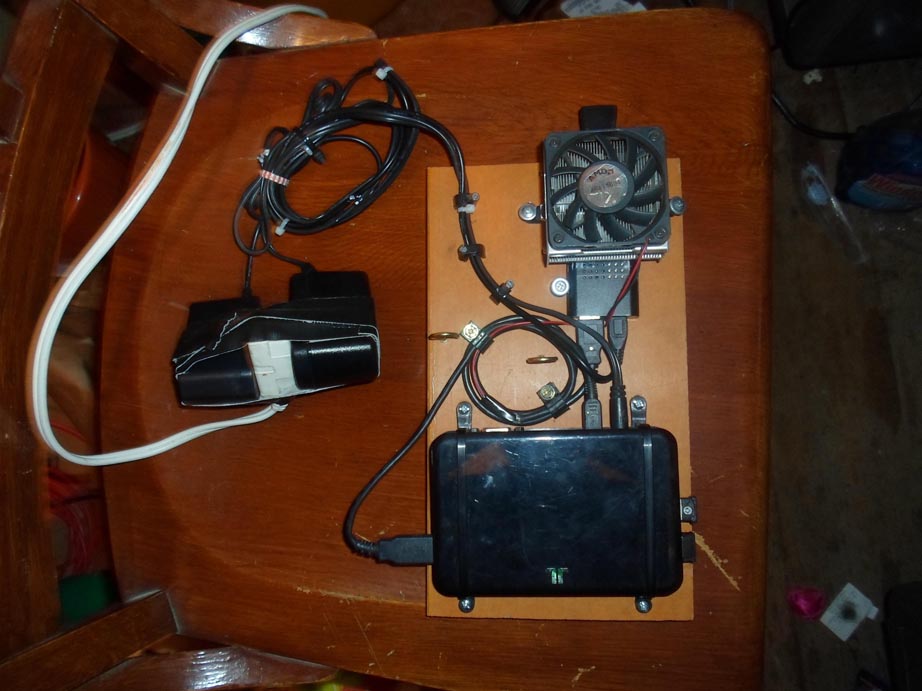

    Just figured I'd finally post pics of some of the mods I've done to a few sticks. None of these are the tronsmart mk908 I've been working with on here, but the principles would of course apply to a variety of sticks.
    So here you go.
    This is my favorite. It's a UG802 with a laptop heatsink and fan (heat transfer pad between heatsink and cpu), usb network, an actual antenna, and of course the usb hub also onboard. This thing works awesome. I wish the fan was a bit quieter but meh... I can unplug it if I want to. I know there can be issues running the fan from the stick's power but I have had none. This one also has an overclocked kernel installed.
    This is a Zeals UG802 with a 12v AMD Socket A style fan running on 5volts from the powered hub there. This one is running ubuntu as the android offerings for this stick seem to be somewhat crappy, or at least they were last I checked. You can see my lovely 2 power supply combination there also. This one runs very quietly but the fan definitely spins fast enough to dissipate all the heat. I use thermal transfer compound between the heatsink and the tv stick - these gk802's have a metal case with a heat transfer pad that touches the processor so cooling the case can work just fine. The hub also has sound, video, and lan. The sound and lan work, but haven't had any luck with the vga, which I assumed would be the case.

    Anyway, hope you all like the photos, and good luck to others who are modding their devices for cooling!
