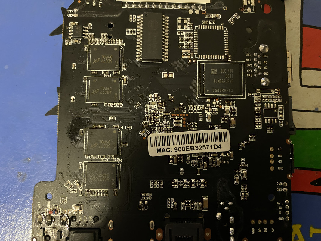

    X96 Air sloution:
    1. Insert the USB cable into PC, run USB_Burning_Tool software, select importing the *.img file, and click Start.
    2. Clean the chip pins marked on the motherboard.
    3. Short-circuit 2 of them (probably 4th and 5th pins). At the same time insert the USB into the USB3.0 interface.
    If the short circuit is correct, your PC will immediately discover the device and start flashing the machine when the USB cable is plugged in. Otherwise, re-select the shorting point and plug in the USB.
    Enjoy

    WARNING!
    Not recommended for unbricking your device, dont strip off any protective varnish, to expose copper lines lying underneath, you can easily damage PCB.

      Originally posted by mAtvXk View Post
      This is the X96air_V2 board, it has been awhile but I believe the ORANGE Arrow+Circle marked pins are the ones I used to reset my box.
        Orang arrow+circle - for P2 board too, Im sure about that, because I was drawing it, and a have a p2 board.
          Dam, this guy is that crazy ...but I like he does thinking not straight forward but alternative :-P....
          Tried it...is working my 2GB bricked device gets recogniced again!
          But now I am facing issue: P1,P2 blabla...dam
            More suitable way, how to unbrick your X96 Air tv box.
            First:
            Tested on V2 board, by shorting orange marked location.
            Second:
            *photos source 4PDA.ru
            View images: RIGHT click / Open link in new tab
              First:
              Second:
              There is rev. 3.0 and 3.1 meanhwile :-P ...so crazy....

                sure have to be careful....but it is working!
                Even tried on other boards...working too :-P
                  Hello!
                  Works on my X96 air. Not a P1, P2, P3, P4 but boot ok with the P1 firmware.
                  Tested on my board, by shorting orange marked location.
                  The number of the mother board : BM805H_141 V3.2 20352 5020.
                  Thank for your work.
                    Hi,I have a X96air p3
                    can Anyone help me find which pins to short for recovery.(its slightly different than first on post #6) - I tried and it didnt work.
                    Thanks in advance.
