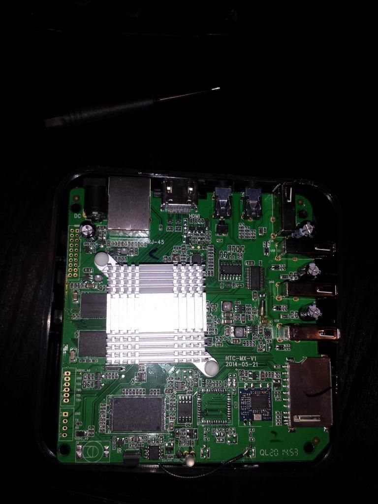

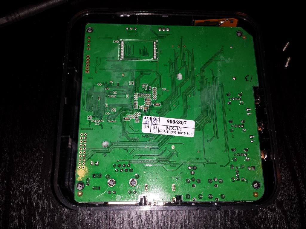

Just got in 2014 Version of MX box PCB says HTC MX V1 2014-05-21
PCB

There is an updated version of the board now out - V2. This has the following mtd layout, and no recovery when you press the reset button:
dev: size erasesize name
mtd0: 00800000 00400000 "logo"
mtd1: 00800000 00400000 "aml_logo"
mtd2: 00800000 00400000 "recovery"
mtd3: 00800000 00400000 "boot"
mtd4: 40000000 00400000 "system"
mtd5: 20400000 00400000 "cache"
mtd6: 10000000 00400000 "backup"
mtd7: 18b400000 00400000 "data"
mtd8: 00060000 00001000 "bootloader"
mtd9: 00008000 00001000 "ubootenv"
