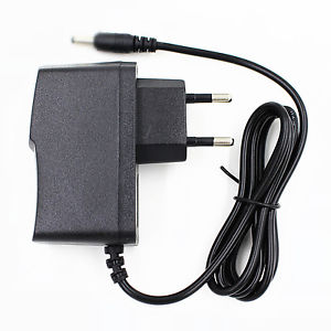

                      I have a similar problem and i was told it is not a system but a defective adapter, specifically a condenser cover.
                      I have a new original adapter ordered so I can not say yet whether it's true.
                        Gante
                        What do you mean by the 'Adapter' exactly?
                        Also I do not understand what is condenser !
                        ​​​​​​​thank you
