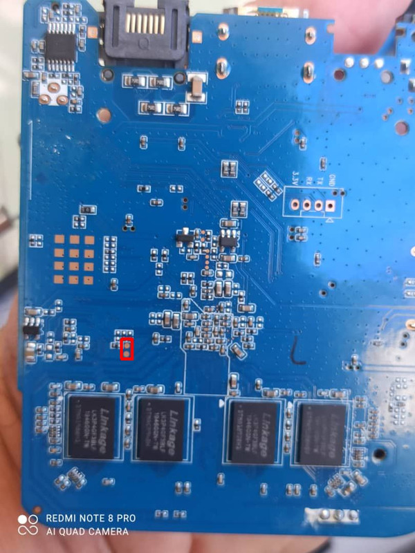

Friends, I am new to this post and I wanted to explain that I have a Mecool KM9 pro Deluxe tv box, and I have blocked the equipment after using a fake rom using the Anlogic USB burning tool method. Now the device turns on the blue LED but I have no video output and I have tried some methods to try to revive it, such as: burn card maker through the .img file. I would appreciate if someone could tell me where I locate the pins on the board using the short pin method and I can have the tv box with me again. Funny
raul.velis
Try the 2 pins inside the red square I have placed to your photo. These must be the correct points to short, but as always whatever you do you are doing it at your own risk. Good Luck.
