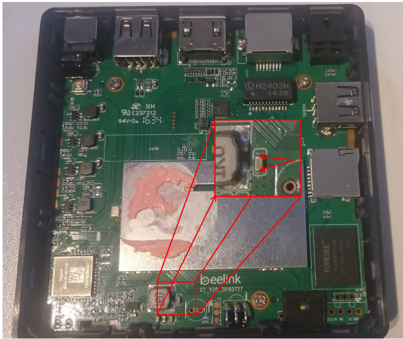

Originally posted by matrix55a View PostHi, can you help me with MXQ PRO 4K. Short pin 6/7?
Thank you.
First image below cpu heating are test points
3.3 volt
Tdi
Tdo
Tck
Gnd
And others
What happens if you bridge gnd and tck(test clock)
If you want to tickle the Nand
Third image
There are 4 inner test points right beside chip
Bridge the upper 2
Maybe will work
Are you sure you even need maskrom?
Can be many issues with UBT
Happy Testing
Thank you for your reply. I bridge tck and ground and nothing happend. Where is 4 test point in Image 3? I need maskroom because my reset switch dosn't work. In atvXperience_v2E firmware dosn't work remote tool and wifi. When i update OTG this firmware 20170215 mxq pro s905x软件 get acces to android recovey mode but i can't upload img. I don't copy my remote.conf because user not root :-(
Install Terminal Emulator apk in Android
Type reboot/ recovery
Make sure UBT is running
You have loaded image
And hit start button.
Should recognize and start Flash
Img 3 if you expand for closer look the points are there right tight to edge of chipset
Upper n lower
Further good luck
Happy Testing
