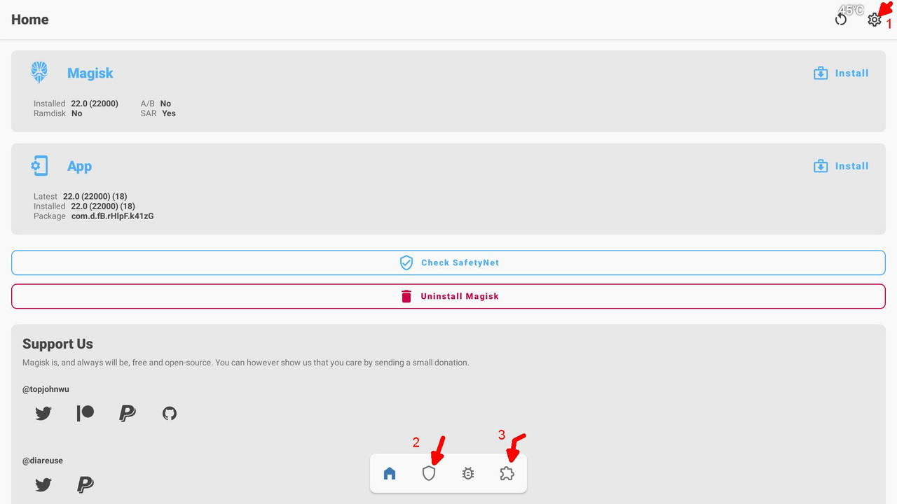

    Originally posted by tulkar View Post
    Hi, I have installed your rom for HK1, mainly because I needed magisk to use rclone mount, I tried to use rclone module but was asking me to update magisk to latest version , I did but not working properly, could you please release the rom with updated magisk??
    thanks
    As I already answered in PM there is no need for a new release of the rom with updated magisk. If you update the preinstalled Magisk from inside it correctly, you will get the latest versions for both Magisk and App (which as of today is version 22.0 for both of them). You will get something like this (this is a screenshot of my H96 max X3):
    You may need to use "1=Cog Wheel", "2=Superuser" and "3=modules" and "Hide" options in order to succeed in what you need. For further needs (accessing special services, modules etc) you may need to do further steps which are described in a Help PDF file I have long ago made (if you need it please sent a PM).
    thanks
