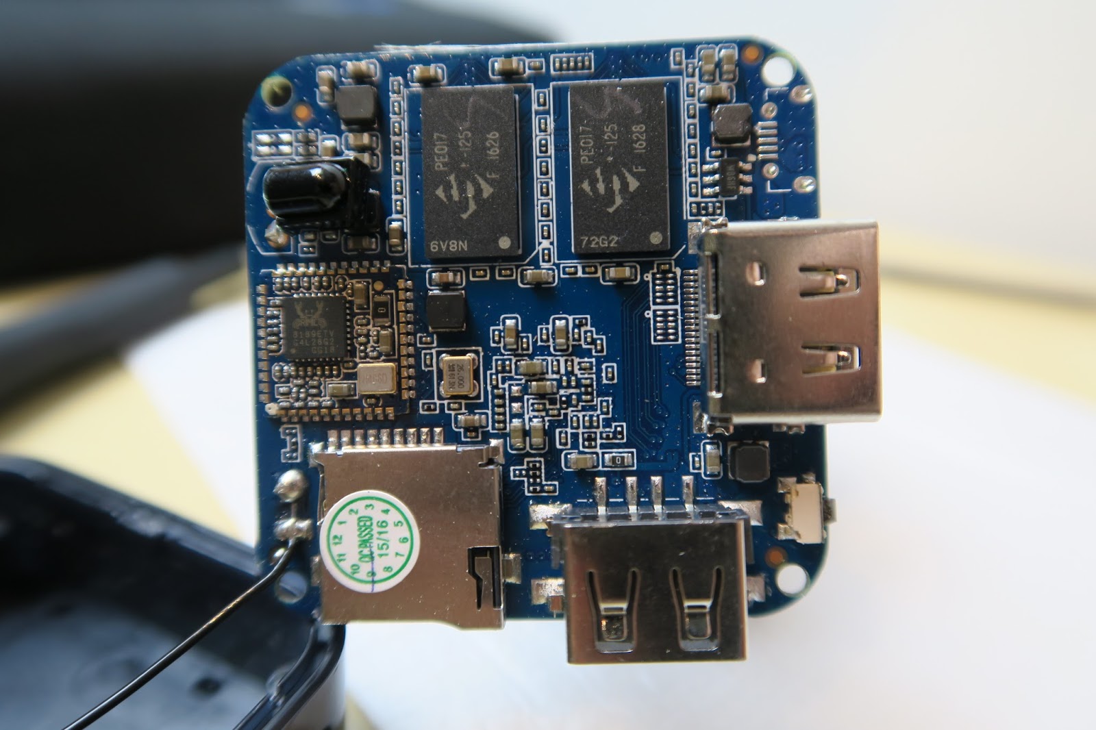

            Originally posted by minixfreak View Post
            some t95n come with ddr4 memory and different uboot ....thats probably your problem so wont work
            I dont think this is the case, it uses SPECTEK PC3-12800/DDR3 1600 11-11-11 modules
            like the ones on this pic:
            https://4.bp.blogspot.com/-oXm0ijBv6...0/IMG_7427.JPG
            My board says S905X_V1.2 20160621, its a 1GB/8GB model with an EUDAR eMMC
            Apparently, from what I found out, its a Sunvell T95X clone
              #51
              then it could be a bootloader change and maybe it will work send me the nougat firmware for your device
