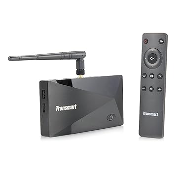

            Hi wasser,
            I own a Tronsmart R28 Meta and I've also got the problems with DTS output.
            DD5.1 works fine (but shows as DTS5.1 on my Sony Receiver), DTS has no output - both with SPDIF and HDMI!
            Stock firmware and all other R28 firmwares on freaktab do not have this issue. I prefer to use Stock Player but MX-Player also does not work. After installing DTS Codecs for MX Player, I get sound playing the DTS audio track but only PCM2.0.
